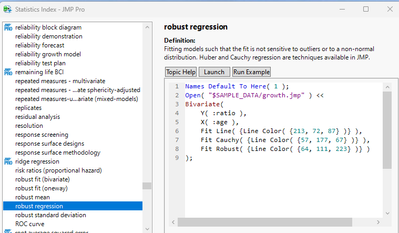

I will point you to the Statistics Index.  There you will find pointers to the Help pages for Robust Regression, and also an actual Example of a Robust Regression run in JMP.
     Help=>Statistics Index

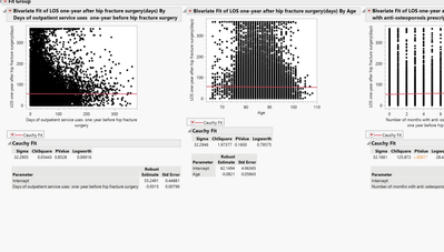

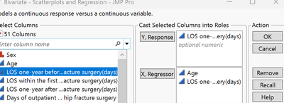

However, I have come across a new challenge in my research, and I was hoping you could provide some guidance. In my current study, I am trying to predict a dependent variable using multiple independent variables simultaneously. While I have successfully included these variables in the analysis, I realized that the results only present bivariate relationships and do not report the model fit of the regression.

For multiple linear analyses you need to look into the Multivariate Platform, or the Fit Model Platform.
I suggest that you take the time to read the Discovering JMP documentation available under the Help pull down menu.  You may also want to explore the JMP Tutorials.
