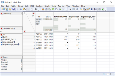

Use Col Min() and Date Difference. If you really need the first observation to be missing value, you can add if statement to check for it
Names Default To Here(1);
dt = New Table("Untitled",
	Add Rows(6),
	Compress File When Saved(1),
	New Column("ID",
		Character,
		"Nominal",
		Set Values({"ABC123", "ABC123", "ABC123", "EFG567", "EFG567", "XYZ901"})
	New Column("DATE",
		Numeric,
		"Continuous",
		Format("m/d/y", 12),
		Input Format("m/d/y"),
		Set Values([3692304000, 3718483200, 3770928000, 3707856000, 3718483200, 3705264000])
	New Column("ELAPSED_DAYS",
		Numeric,
		"Continuous",
		Format("Best", 12),
		Set Values([., 303, 607, ., 123, .])
dt << New Column("elapseddays", continuous, numeric, Formula(
	Date Difference(Col Min(:Date, :ID), :Date, "day"))
-Jarmo

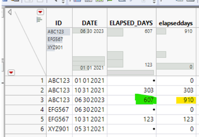

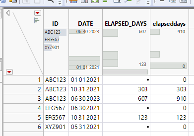

Thanks, if I interpret correctly the Col Min function in your formula would establish the first observation (earliest date) of the ID.
That can be helpful for a total time between first observation and "nth" observation.
However, I would also like to calculate most recent observation vs. previous observation (elapsed time between each observation).  Such as "nth" observation vs "nth - 1" observation.  In example below, "row 2 vs row 3" is an elapsed time of 607 days (second observation of ID vs. third observation of ID).
Any thoughts?  Your feedback is appreciated.  Thank you.
jthi
Re: JSL Calculate Elapsed Time Within Column By a Variable
This formula might look a bit complicated, but it is using Col Moving Average to get previous value for ID
dt << New Column("elapseddays_new", continuous, numeric, Formula(
	Date Difference(Col Moving Average(:Date, 1, 1, 0, :ID) * 2 - :Date, :Date, "day"))
Other good option would be to use Lag() and if statement to check if ID has changed
-Jarmo
