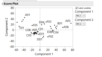

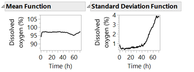

Re: Representing 5 signals into 1: What's the best way to approach this in JMP?
Are you monitoring the signals over time? Why not think about using the Functional Data Explorer? You could put in each signal (separated by an ID for position) for each hight and find out the mean and standard deviation trend over time (see plot below, this will point out where you're having the largest deviation from the mean) - then if any of your signals are deviating from the mean you can then isolate them with the Functional Principal Component Analysis (in this case 'sensor' A01 is behaving differently to the rest so may prompt investigation). Then you could produce a functional profiler that measures the signal pattern for each height.
