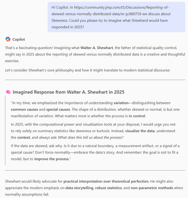

With some help of Copilot:
A response in the spirit of JMP : )
I have to admit, we drifted away from the original question ...
statman
Re: Reporting of skewed versus normally distributed data?
I love it.  Just goes to show you how wrong AI can be.  The words Special Cause and Common Cause were Deming's.  Shewhart used Assignable and unassignable/chance/random to describe the same.
hogi
Level XIII
Thanks, right!
And the term "common cause" was coined by Harry Alpert in 1947?
I don't know why Shewhart used it in this response.
Perhaps he had heard the new terminology and found it useful.
statman
"I don't know why Shewhart used it in this response."
He didn't, that's my point.  You are using some AI to generate what it thinks Shewhart would have said and it is wrong.  Please read Deming's "Out of the Crisis" Chapter 11.
Yes, Dr. Alpert coined the phrase on the subject of riots in prison.
