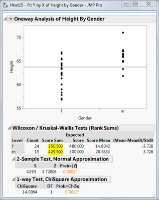

Like so much in statistics, there is seemingly a number of ways to get what you need. sebastianhoffmeister pretty much was on point with his response, and JMP indirectly reports the statistic that you need. As your question title implies, much like the Wilcoxon Rank Sums test itself, the U statistic is named depending on the source. After looking this up before answering your question I found that in the Wikipedia entry, which is for the Mann-Whitney U test, it is the U statistic. In a statistics textbook I have here in my cube (Ott and Longnecker, 5th ed.) it is referred to as the T statistic, but an example in the chapter on the Wilcoxon test has an example from Minitab where it is explicitly stated that the "test statistic W… is identical to the Wilcoxon T."
In JMP the Wilcoxon statistic is S that, according to JMP help, is the sum of rank scores. S is not U/W/T, but appears to be the greater of the score sums; note in sebastianhoffmeister's screenshot S = 429.5, the score sum of level m. the U statistics can be computed from the score sums, s1 and s2. If you refer to the Wiki entry, you will find that in sebastianhoffmeister's example, U1 = 50.5 and U2 = 309.5. According to the Wikipedia entry, U1 should be chosen, meaning the value of S would be 350.5, but JMP chooses the larger U statistic that also happens to be the larger score sum.

As far as I know, there is no explicit way to do that in JMP. But of course JMP is reporting the score sums:
To get W you would just take the Minimum from those sums if I remember correctly.

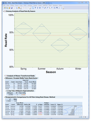

If you are trying to determine where differences exist when a footer has there or more levels, JMP can handle the pairwise testing for you with nonparametric statistical tests just as it does for an ANOVA. In the screenshot provided by sebastianhoffmeister, he provides a test on a factor with two levels. In that case running the Wilcoxon test (Nonparametric > Wilcoxon Test) provides two results: the normal approximation and the Chi-squared approximation. The previous is the result of the Wilcoxon Rank Sums test, whereas the latter is the result of the Kruskal-Wallis test. If you are fortunate enough to have JMP Pro, the results of the Exact test should also be shown. The Exact test should be used in place of the normal approximation when sample sizes are small (N ≤ 20).
When your facts has only two levels, the result of the Wilcoxon Rank Sums test will let you know if there is a significant difference between the two levels. If you have more than two levels, the Kruskal-Wallis test will only inform you that at least one of your levels is significantly different. An example of nonparametric testing with more than two levels is shown below.
Note that there is no 2-sample test result (normal approximation). JMP does not display results for the Wilcoxon Rank Sums test in my example, as it is non-applicable. The result of the Krusal-Wallis test was that a season effect was detected (p = 0.0008), so I used the Steel-Dwass method for pairwise testing. The Steel-Dwass method is the nonparametric equivalent of the Turkey HSD (also known as the Turkey-Kramer method or Tukey's range test). In order to get the pairwise test results you go to Nonparametric > Nonparametric Multiple Comparisons where you will see a selection of nonparametric pairwise tests. For more information on these tests you can begin by referencing the JMP online help on nonparametric oneway analysis. The online help should have enough for you to get started in determining which pairwise test is applicable to your analysis.
