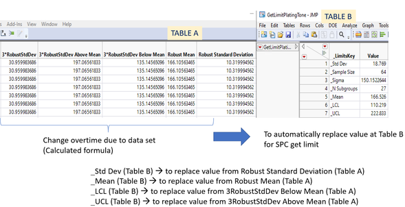

Hello Experts,
I'm trying to automate updating my "GetLimitTable" with new data (I'm using Levey Jennings).
How to replace value of specific row in Table B with value from specific column in Table A?
For example, I want to;
-  replace row _Std Dev Value from 18.769 (Table B) with 10.312 (Robust Standard Deviation Table A)
-  replace row _Mean Value from 166.526 (Table B) with 166.1056 (Robust Mean Table A)
- replace row _LCL Value from 110.219 (Table B) with 135.145 (3*RobustStdDev Below Mean Table A)
- replace row _UCL Value from 222.833 (Table B) with 197.0656 (3*RobustStdDev Above Mean Table A)
Thank you in advance

Re: Replace value of specific row in Table B with value from specific column in Table A
Assuming the row you want to get the data from in Table A is row 1, the following script will show you how to read from Table A and write to Table B
Names Default To Here( 1 );
dtA = Data Table( "Table A" );
dtB = Data Table( "Table B" );
dtB:Value[(dtB << get rows where( dtB:_LimitsKey == "_Std Dev" ))[1]] =
	dtA:Robust Standard Deviation[1];
// Repeat for each of the values you need to transfer
Jim

WebDesignesCrow
Awesome Jim!
It works. Thanks
