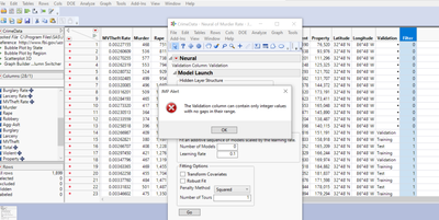

I am testing several models as part of JSL loop in JMP 16, using different validation columns to determine how the R2 values change depending on what data is used.  Each validation column contains a subset of the data, with some missing data at the beginning and/or the end of the column.
Other models, such as the Bootstrap, run well simply ignoring missing values but the Neural Net keeps throwing an error message (reproduced on the JMP sample data set, CrimeData).

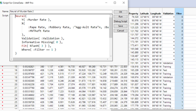

I can work around the problem by including a filter column, setting all missing values to 0 and not running them.  But this will require a filter column for each validation column (or dynamical creating/deleting a column each iteration).
Neural(
Y( :Murder Rate ),
X(
:Robbery Rate, :"Agg-Aslt Rate"n, :Burglary Rate, :Larceny Rate,
:MVTheft Rate
Validation( :Validation ),
Informative Missing( 0 ),
Fit( NTanH( 3 ) ),
Where( :Filter == 1 )

  It would appear that your validation column is not filling all the rows because you are stratifying your validation column on some other column(s) that has missing data. My guess is JMP doesn't know how to deal with those rows in the validation column because there is missing data.
  Do you plan on modeling an outcome where you have missing data? If not, then you could consider excluding those rows where you have missing data -- this is essentially what you are doing with the filter column, but by excluding those rows, you don't need a new filter column for each validation column you test. You can also easily set the row state as Exclude in JSL so that it's automated and you don't have to do it manually.
  If you still need to model the data where you have missing data, then you might consider not stratifying on any columns and just randomly generating training/validation columns. JMP will assign each row to the proper data set even if there is missing data.

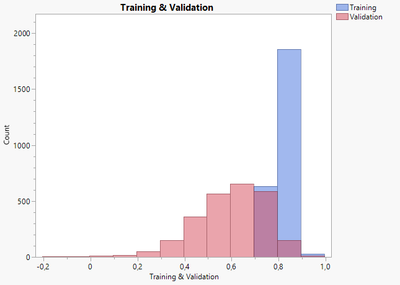

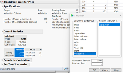

  • In the modeling, you can also more easily try different resampling between training and validation sets, by right-clicking on the performance metrics you would like to evaluate with various training and validation sets, click on "Simulate" and here you will have the option to switch in and out your validation column :
By doing this you'll get a datatable with all the simulations done on various training and validation sets, and you can plot the performance variability obtained with these simulations (here for R² on the toy dataset "Boston Housing" with Random Forest):

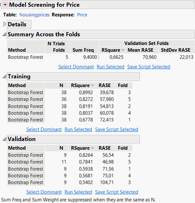

          2. Use the Model Screening Platform (jmp.com) platform with only the model you want selected and the validation method you want (K-folds, Nested K-folds, with the option to repeat them, or validation column), and launch it. You'll get access to the results summary, but also the individual folds results :
When selecting for example one fold to run the model (here I tried with fold3), a new column will also appear in your datatable, in order to know which rows in this fold were used as training or validation (0: Training, 1: Validation) :
I think these methods may be useful for you, with less manual work and greater flexibility.
