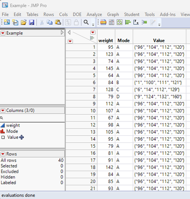

Hi,
I created variables that are list. I want to create new column that under if statement will fill up the cell with those variables. So I can get table as below. How can I add list into a cell?
A={"96", "104", "112", "120"};
B={"1", "100", "111", "121"};
C={"6", "14", "112", "129"};
D={"9", "124", "132", "160"};
dt << New column("Value", Expression, formula(
	if (
		:Mode=="A" , A,
		:Mode=="B" , B,
		:Mode=="C" , C,
		:Mode=="D" , D,

Your code works fine for me
Names Default To Here( 1 );
dt = Current Data Table();
A = {"96", "104", "112", "120"};
B = {"1", "100", "111", "121"};
C = {"6", "14", "112", "129"};
D = {"9", "124", "132", "160"};
dt << New Column( "Value",
	Expression,
	formula(
		If(
			:Mode == "A", A,
			:Mode == "B", B,
			:Mode == "C", C,
			:Mode == "D", D
Jim

Besides missing few closing brackets and having extra , I don't see issues with the script as @txnelson also said
Names Default To Here(1);
dt = New Table("Untitled",
	Add Rows(5),
	Compress File When Saved(1),
	Set Header Height(46),
	New Column("Mode", Character, "Nominal", Set Values({"A", "C", "A", "A", "D"}))
dt << New Column("Value",
	Expression,
	formula(
		If(
			:Mode == "A", A,
			:Mode == "B", B,
			:Mode == "C", C,
			:Mode == "D", D
If you need to have a formula and not values in those cells, I would suggest checking out Insert one expression into another using Eval Insert, Eval Expr, Parse, and Substitute  as it will most likely prevent some issues which might occur.

Hi Jim,
Your are right. I 'm not sure what was the problem that it wasn't working previously. It works after I close JMP and reopen it.
