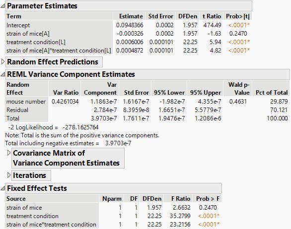

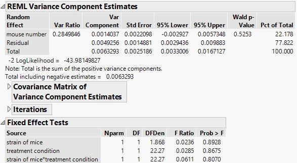

Re: Repeated vs Replicates vs multiple observations and nesting
"You can see a lot just by looking."
As suggested by the plot, there is nothing to be found for the mineral amount.
The carbonation amount, on the other hand, shows some fixed effects.

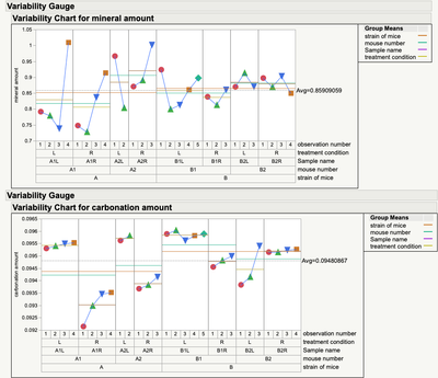

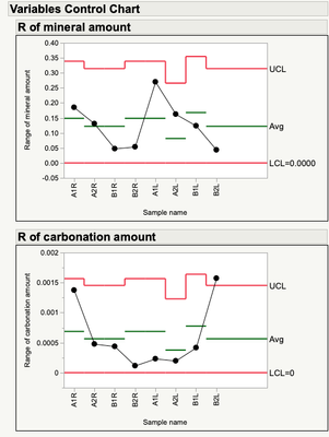

You have some interesting measurement variation.  Particularly where there are some "unusual data points" or special cause variability.  Might want to look at those before going to far (analysis wise) with the averages.
statman
Forgot to add...I have no idea how much of a change in the Y's matters. If the variation you see above is small compared to practical significance, it might not matter.
