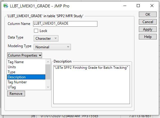

Hi, I am trying to script for my column names to be replaced with a specific column property called "Description". How do I extract whatever is stored under description and use that as my new column name?
I tried running my own script but it didn't really work out
dt = Current Data Table();
For( i = i, i <= N Cols( dt ), i++,
 newname = (Column( dt, i ) << Get Column Properties("Description"));
Column( dt, i ) << Set Name(newname);
Appreciate the help!

Thanks Jim! Unfortunately it's still not working even with the tweaks you suggested. I am not sure if it is my file. I tried using the Debug Script option but it crashed on me. I tried it on both JMP 14.1 and 15.0 and both could not execute the Debug Script.

Jim, the script works now! just had to tweak Get Properties to Get Property. thanks so much :)
