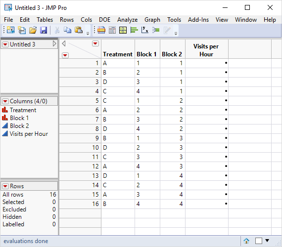

The response is the number of visits in a one hour run. You have one categorical factor with four levels (A, B, C, D). You have two blocking factors each with four runs. (You did not specify the nature of the two blocking factors.) There are a total of sixteen runs times five replicates. Here is the set up of your Latin Square design in JMP for the proper analysis:
That might not be what you intend to do ("freely choose from all of the treatments"). The design presents one treatment at a time. Is that clear?
You could enter the replicate values in the same row and then stack these response columns before analysis or you could add four replicates of these rows and enter the observations in one column as shown.
It is not clear about how the nine subjects are used in this experiment ("9 animals are released into an enclosure "). Are they tested individually (one at a time) or together (nine at the same time)? The answer will determine how the effect of the animals enters the model.
See Help > Books > Fitting Linear Models for more details.

All animals are released at the same time in the 4x4 enclosures. And every 10 sec the position of the animals in a given RxC (e.g. A1) are recorded.
