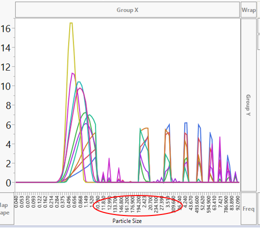

I am trying to plot some data in graph builder, but the numeric values (x axis below) plot in order of the number while ignoring the decimal place. I am plotting overlays that use the same 116 numeric categories on the x-axis, so dragging these values manually is not efficient. The values are in the correct order within the data table. What settings can I use to maintain either the order assigned in the data table or force them to read from smallest to largerst without ignoring the decimal place?

If you make your x axis variable continuous, I believe that would correct the problem.

Perhaps you have a value ordering property turned on? Any chance you could share some of the data?

I had already assigned it as continuous. I reattempted that and I get the same issue. I have also tried fixing the decimal places to three. (for example values with 0.001, 0.010 and 0.100). Neither of these seemed to work.

We were both headed in that direction. There was a value ordering setting already applied in the data. I removed this and reset all the column settings. I am now getting the plot I need. Thanks for the help, Dan!
