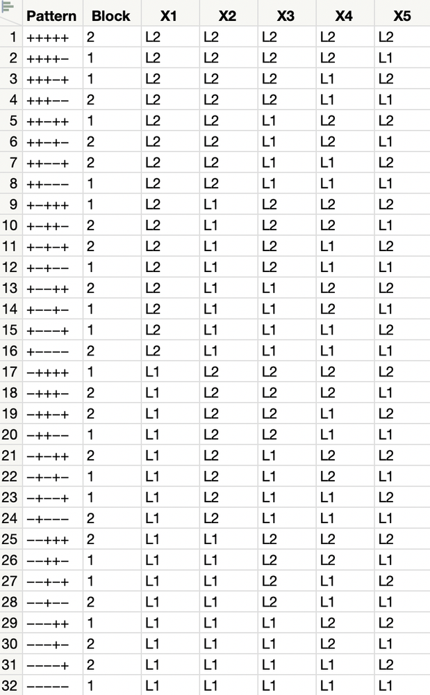

Full factorial design for 5 two-level categorical factors in two blocks:

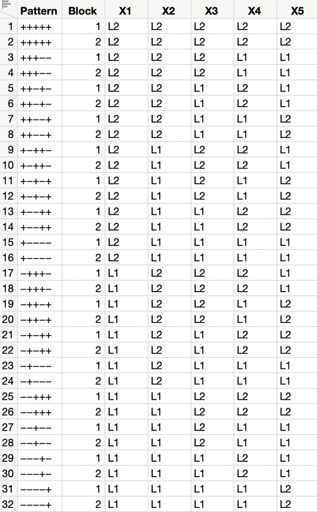

Replicated half fraction design for t two-level categorical factors as two blocks:
