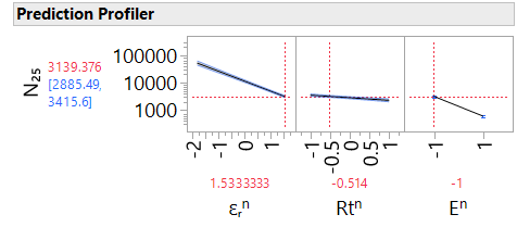

I've a model with only a few active effects. Namely the three main effects in the table. epsilon_r^n and and Rt^n are continuous variables, but E^n is a categorical variable that can have the values -1 and +1.
From the prediction profiler, it is clear that in all three cases, a higher value for the independent variable leads to a lower predicted N25 (which is also expected from a physical point of view).
Then why are the estimated coefficients for epsilon_r^n and Rt^n negative, but the coefficient for E^n is positive? How should I interpret the expression "[-1 -1]" in the parameter table?
Saving the model to the data table give access the the following model formula:
So the higher value of E^n (i.e 1) leads to a lower value in the formula (i.e. 0). I'm not sure how I should get this information from the parameter estimates table. Could some explain this to me, please?

  That being said, since you have made E^n a nominal value, when JMP reports the parameter estimates, it reports back the possible values, in this case [-1 -1], meaning -1 to 1. To better understand how the E^n predictor fits into your model, you might want to change it to ordinal instead.
  The reason why E^n gets a positive coefficient (or 0) has to do with the function you get back out for your prediction. Your formula is basically the following:
y = exp( a + b*x_1 + c*x_2 + d*x_3 + f )
  To get a larger y response, the argument of the exponent should be as large as possible, hence if the coefficients for x_1 and x_2 are negative and "a" and "f" are positive, the only way to get a larger value for the argument is to make the coefficient for x_3 (i.e. E^n) be positive.

Re: interpretation of parameter estimates for catorical variable
Dear DS,
Changing E^n from nominal to ordinal indeed did the trick. The absolute value for the parameter is the same a before, but the sign changed to negative which is much more intuitive. Thanks a lot!
