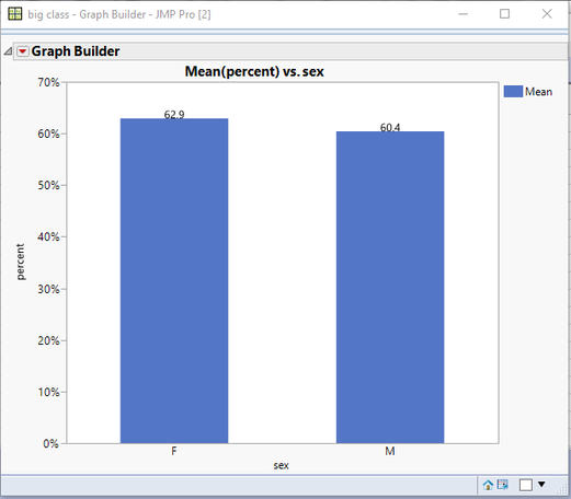

The only way that I think you can do what you want is to add the labels by writing some simple JSL.
Names Default To Here( 1 );
dt = Open( "$SAMPLE_DATA/big class.jmp" );
dt << New Column( "percent", Format( "percent", 12, 1 ), formula( :Height / :Weight ) );
gb = Graph Builder(
	Size( 528, 448 ),
	Show Control Panel( 0 ),
	Variables( X( :sex ), Y( :percent ) ),
	Elements( Bar( X, Y, Legend( 6 ) ) )
gbr = gb << report;
flist = {.0};
Insert Into( flist, Round( Col Mean( If( :sex == "F", :percent, . ) ), 3 ) );
f = Char( flist[2] * 100 );
mlist = {1};
Insert Into( mlist, Round( Col Mean( If( :sex == "M", :percent, . ) ), 3 ) );
m = Char( mlist[2] * 100 );
gbr[framebox( 1 )] << Add Graphics Script(
	Text( Center Justified, flist, f );
	Text( Center Justified, mlist, m );

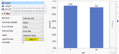

Here is a solution for newer versions of JMP
We can start with the same example as the previous post
gb = Graph Builder(
	Size( 528, 448 ),
Then in Graph Builder choose Label -> Label By Value.  This will show the extra % symbol
Under Label Format, click on the Auto dropdown (twice) and choose a new format.  One option would be best or fixed dec, but this will show the format as a decimal value
To get that value * 100, but without the percent symbol click on the dropdown again and choose Custom
Click Set Custom Format
The formula editor will open with the word value in the middle.  Click the multiplication button and then type 100
Click OK
