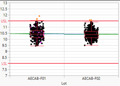

Hi all,
I have a function that creates cdf plots with lower and upper limits. However, when applied, the lower/upper limits are not being shown because of the axis minimum and maximum. What/how is the proper computation in order for the lower and upper limit to be shown from the plots?

I have this plot as the result:
But it should be like this:

Two items
  1. Your ul list has character values instead of numeric values
    ul = {11.5, "20", "100"};
  2. You need to check to see if your cmax and cmin are outside of your ul and sl values and if so, then reset their values.
    Try( cmin = rcdf[s][axis box( 1 )] << Get Min() );
    		Try( cmax = rcdf[s][axis box( 1 )] << Get Max() );
    		range = abs(cmax-cmin);
    		if(sl<cmin, cmin =sl-.1*range);
    		if(ul>cmax,cmax=ul+.1*range);
Jim
