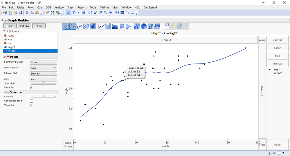

Hi All,
I was wondering if the is a way to define that coordinates will not be shown when hovering the cursor over points?
By default, when hovering the cursor over a point in any graph, the label is given together with the coordinates.  I would like only the labels to be shown. In the example picture, I would like not to see the height and weight but just the name.
Thank you!

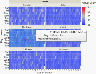

If the graph contains subplots via Wrap, Group Y or Group X, the Hover Label Editor even allows to define for each subplot different values to be added or removed from the respective hover labels.
On the other hand:
Is there also a possibility to define the same setting for all subplots at once, like a checkbox in Hover Label Editor: apply to all plots?
Or is the only way to code it in JSL?
View more...
Open( "$SAMPLE_DATA/Airline Delays.jmp" );
gb = Graph Builder(
	Size( 528, 485 ),
	Show Control Panel( 0 ),
	Graph Spacing( 5 ),
	Variables(
		X( :Day of Month ),
		Y( :Day of Week ),
		Wrap( :Airline ),
		Color( :Arrival Delay )
	Elements( Heatmap( X, Y, Legend( 9 ) ) )
frameboxes=Report(gb)<< xpath( "//FrameBox" )
for each ({fb,idx},frameboxes, fb <<Set Gridlet( Expunge( {{Matcher( "Day of Week" )}} ) ))

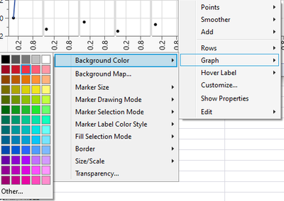

Ah:
If the user presses CTRL at the moment he clicks on HoverLabel/Paste Graphlet, the code is applied to every single Framebox.
I knew this trick to apply synchronous changes to report structures, but did not know that it works as well for functions in the Graph Builder right click menu.
cool!
Just try: CTRL + Graph/Background Color ...

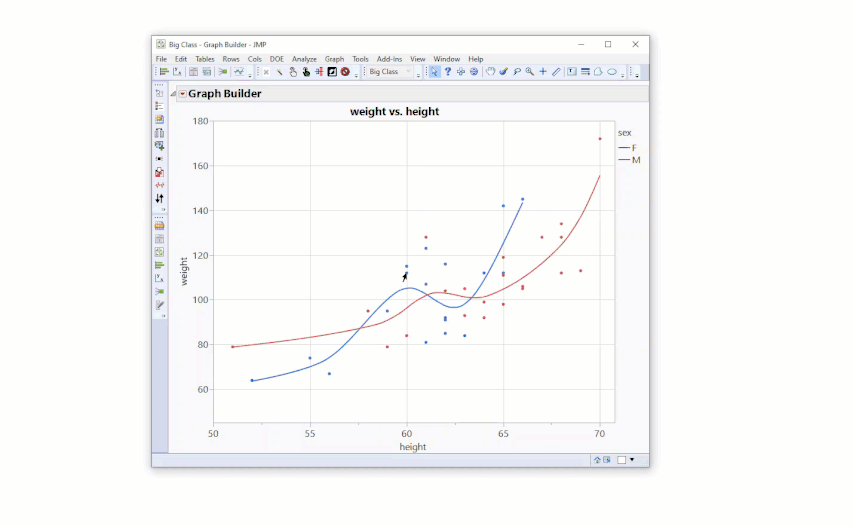

Re: Remove non labels from hovering information
I found a quite convenient way: Instead of opening the Hover Label Editor,
place the mouse over a data point to open a Hover Label - then right-click on the hover label and click on edit
In the menu, there is a preview Hover Label visible on the left where you can click on entries and remove them:
https://community.jmp.com/t5/JMP-Wish-List/To-modify-hover-label-editor-so-it-is-more-user-friendly/...
(also explained in Jmp Documentation Library/Using Jmp/Jmp Reports)
