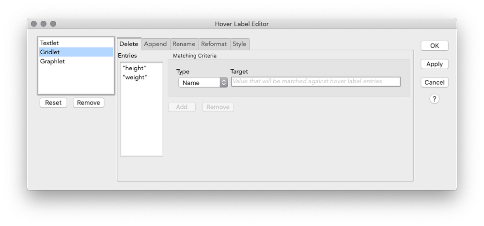

After some prompting by @Mark_Bailey who was sure he saw a way to do this, I investigated further and there is indeed a way to do what you need. You'll use the "Gridlet" option in the hover label editor, where you have the option to modify existing labels by name. Here's how you would do it for your example using Big Class:
  1.  Enter the Hover Label editor by right-clicking the graph > Hover Label > Hover Label Editor
  2. Select the Gridlet section on the left
  3. In the "Delete" tab (the first tab at the top) we may enter the name of the variables we would like to remove from the Hover Label. I'll enter "height" and click Add, and then "weight" and click Add. Do not quote these entries when entering them (even though they will appear quoted once added).Screen Shot 2019-11-07 at 12.07.39 PM.png

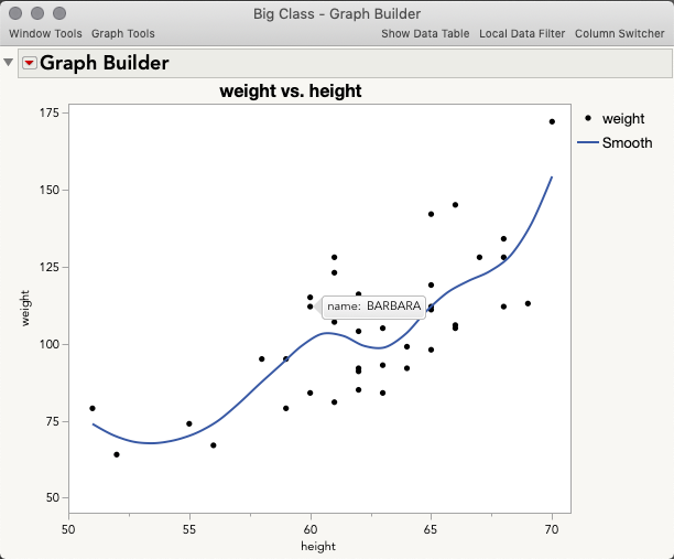

Your hover label will now show only the labeled column of Name:

@ron_horne:You could make your hoverlabel customization more dynamic by taking advantage of the different types of Matching Criteria supported by the Gridlet operators. Let's say you are still experimenting with your graph, and assigning different variables to the X and Y roles. You could refer to the entries you want to remove by Index (one of the options under the Matching Criteria dropbox) and add delete operators for 2 or 3 entries after the first one, which contains the label you want to see.
You can even delete all entries and then use the Append operator to add any content you want - even the values for columns that don't have the Label flag set.
