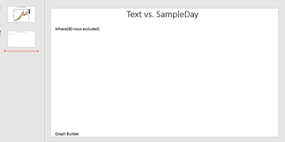

 I'm trying to remove the extra text that is currently exported along side a graph builder output.  Currently it will export the graph as one slide, then an extra slide that looks like this

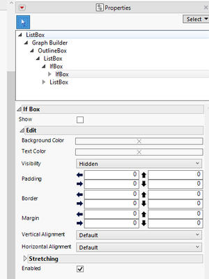

I know that the "Where(xx rows excluded)" text is stored in the IfBox.  If I manually remove or hide that, the graph will export without the extra dialogue text, but I can't seem to figure out what is the right code for removing it.
