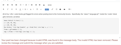

All of my <JSL> code blocks get flagged for errors when posting here to the Community forums.  Specifically, the `class=" language-jsl"` inside the <code> block gets removed, as below
Names Default To Here( 1 );
x = [10, 50, 90];
y = [10, 90, 10];
New Window( "Line Seg Example", g = Graph Box( Line Seg( x, y ) ) );
frame = g[FrameBox( 1 )];
seg = (frame << Find Seg( Line Seg( 1 ) ));

Hi. There appears to have been a change in the Community platform. We have contacted support. In the meantime, we have implemented a temporary fix which should allow you to use the <JSL> button as expected. Thanks.
