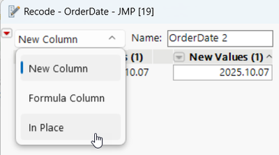

To recode entries in a column and save the result to the same column, one can select In Place from the drop down menu:
In the JSL code the target column will match the input column.

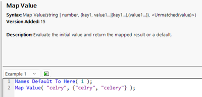

b) even after removing short date() it doesn't work. Because  Map value() doesn't allow expressions? maybe:
