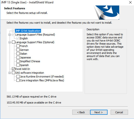

You've got the single-user license version of JMP which is only 32-bit. Our annual license version is the only version available in 64-bit.
-Jeff

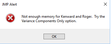

However, allow me to point out that my data is 5400 stores, each with 5 observations, that's 27K rows. I'm attaching an example of how it looks (first few obs). In each time period, we take note of the type of management that store had.  Now I want to model the cost as a response variable, while the type of management as the predictor, over the five time periods. As mentioned above, we have 5400 of these stores hence 27K obs. My understanding is that this is a case of repeated measures.
This is how I'm doing it through the GUI .
And this is the error message it brings up when using the full-blown data:
I thank you again for your time and help.

mragaa
Level II
Re: REML mixed model: "Unable to allocate enough memory" error message
Yep. That's quite like it. I must say I'm impressed of how you could recreate it by a script. Respects!
I've run the model and I'm getting the same error message again:
Before starting the analysis, my computer had about 8 GB of free RAM. If the same experiment consumed only 6 GB on your end, then why does JMP return such an error message here?  Is there another memory measure I should keep an eye on?
Many thanks!
You provided the specifications of your machine, but are you using 64-bit JMP? On occasion people might be using 32-bit JMP. Using only 32-bit software can limit the amount of memory your computer is able to access, in spite of how much is installed.
Dan Obermiller
@Dan_Obermiller
Yes. You nailed it, thank you.  JMP was installed as 32-bit .
I've tried to uninstall / re-install. Yet, it still puts itself as 32-bit without an option to choose 64-bit. (greyed out in the screenshot below) . Any suggestions would be much appreciated.
@ih
Can't thank you enough. To your point, I did open Task manager on a second screen and observed it as I ran the model. It didn't even catch 50% of memory or CPU usage. Still, I was eyeballing the expansion options on Amazon and saying farewell to the paycheck before we knew it's the 32-bit thing :)
