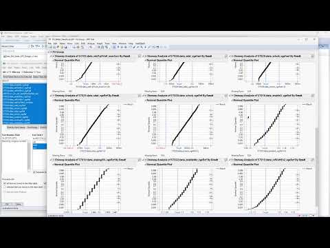

If you're still looking for a scripting-free solution, YieldOptiX supports this out of the box — creating a pass/fail column based on multiple spec-limited columns.
Tutorial at 10:30:
https://www.youtube.com/watch?v=Nx5jWKAl7Z0&t=189s
It's built on JMP and designed for test data workflows.
