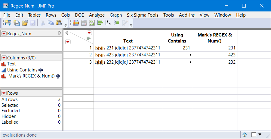

@AlexS ,
Mark, @Mark_Bailey , provided you with the pattern to find any number in the first pattern  "space + any number + space"
Maybe I misread your response but it seemed  to me you were looking for the specific sequence  space + 231 + space.
If yes, an alternative solution is to use the Contains() function. The code is a little more readable. Note REGEX returns a string, so if you want the number you need the Num() function. A table with both functions is attached to this post.
If( Contains( :Text, " 231 " ),
	231

Re: REGEX HELP with White Spaces
This example shows the expression to get the second part of your target based on the example that you provided.
Regex(
	"Jsjsjjs 231 jdjdjdj 2377474742311",
	"\s(\d+)\s",
	"\1"
gzmorgan0

@AlexS ,
	231
