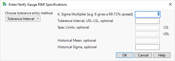

Click the red triangle at the top of the platform and select Gauge Studies > Gauge R&R. You are presented with a dialog box:
The multipliier k is the first parameter with a default value of 6.

The guidance about evaluating Gauge R&R applies to the estimate circled in red.

Regarding my second question, I'm more asking what's the rationale behind JMP using 6? I've also heard that 5.15 is used in some practice. Can I change this sigma multiplier to any arbitrary number like 3?
Gary
RE: Gauge R&R Definitions
The multiplier depends on where you practice. For example, companies that follow the AIAG standard will use k = 5.15, but not everyone does.
Yes, you can enter any multiplier in the dialogl.
