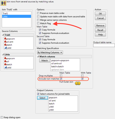

Use the Match Flag option to add a column that indicates which tables contributed to a row in the resulting table. You can delete rows with a 3 in this column.
From the documentation:
• If a one (1) appears in this column, the data originated from the first (active) table.
• If a two (2) appears in this column, the data originated from the second table.
• If a three (3) appears in this column, the data was found in both the first and second tables.
-Jeff

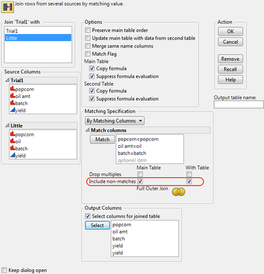

You can use the Include Non-matches options in the Tables->Join dialog to get outer joins.
Will that work for you?
-Jeff

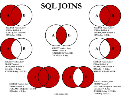

I want either of the two on the bottom right.
-Jeff
