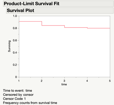

After that, I used the Survival platform (Y=months, Censor=censor, and Freq=died). The result started with day 1. But I want to get this result starting with 0 day (I think it will give me 100% survival between day 0 ~ 1). Here is my current result and thank you for any helps from you.

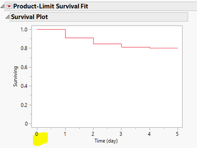

Have you tried to "drag" the x-axis? That is part of the rich interactivity features of JMP. By "drag", I mean the following:
Hover the mouse at the highlighted spot as in the following screenshot. When you see a hand icon pointing to the left, do next step.
Click left mouse button and hold it, don't let it go. Then drag to right, until you see 0 on the axis. Now you can let the button go.
The following screenshot is what I got after that.
