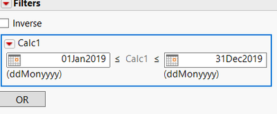

In the database (SQL Server) I get the Date field called RETURNDATE in ‘varchar20’ – I would like to use the Calendar functionality in the filter to select my dates
I tried to create a calculated column (Calc1) and specify CAST([RETURNDATE] as date), which he doesn’t like.

Query builder doesn’t allow the entering of the quoted date string in the filter
Any advice?
