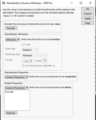

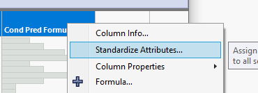

JMP is also able to do this interactively with Standardize Attributes:
Select all columns, right click on one of the columns and select Standardize Attributes:
Add Formula to Delete Properties and press OK (or apply):
If you have JMP16 this will be printed to Enhanced Log:
// Open Data Table: Wheat.jmp
// → Data Table("Wheat")
Open("$SAMPLE_DATA/Wheat.jmp");
// Standardize column attributes
Local({old dt = Current Data Table()},
	Current Data Table(Data Table("Wheat"));
	For Each({col, index},
		{:Variety, :Yield, :Moisture, :Pred Formula Yield, :Cond Pred Formula Yield},
		col << Delete Formula
	Current Data Table(old dt);
And this will give good idea how to handle this (same as txnelson said, loop over the list and delete formulas as you go). You can also get all columns in table with << Get Column Names. You won't be able to remove formulas from columns which don't have them (and the script provided by enhanced log wont work directly like that), but you can circumvent that by wrapping the col << Delete formula with Try(). After cleaning up the enhanced log script you might end up with something like this:
