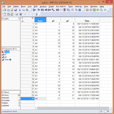

Here is a table that I believe resembles what you are describing (but assume it is in a database rather than JMP):
My understand is that you would like to retrieve one row for A1, A2, A3, and A4 for which Time is the maximum.  Is that correct?

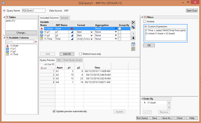

I do not believe that is possible without doing a subquery that uses the MAX function, which you can do using a Custom Expression filter.  Here is the query I ended up with:
In case that is too small to read, the custom expression is:
t1.Time = (select MAX(Time) from parts t2 where t1.Asset = t2.Asset)
So you pass in the value of Asset from the main query (t1.Asset) and select rows that have the maximum Time value for that asset.
