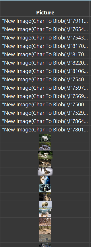

I converted the Picture column from data type Character to Expression to get the images to show in the data table. Of the 2,000 entries, 1986 of them work as expected. 14 of the pictures don't display correctly. These entries include the following pictures:

I have reviewed the Picture information and found that the rows with issues don't have all of their information. The entries end in the middle of the image information.

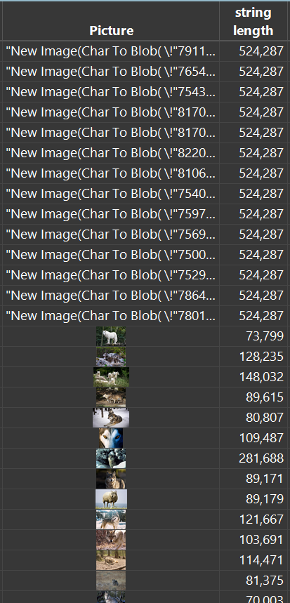

I have reviewed the length of the Picture information and found that the corrupted Pictures all have a character length count of exactly 524,287. (2^19 - 1).

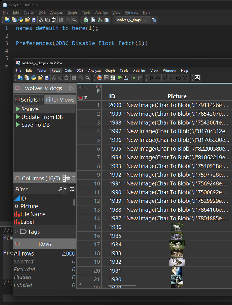

Re: Query Builder - Issue Clipping Large Text Strings
You want to turn off Block Fetching
Preferences(ODBC Disable Block Fetch(1))
using JSL before connecting to the ODBC data source.

I have tried this recommendation and unfortunately it does not appear to work.
I ran the jsl code and then queried my table using File -> Connect To -> ODBC -> Open Database Table.
Despite the preference change, I continue to get long text strings clipped to a character length of 524,287.
