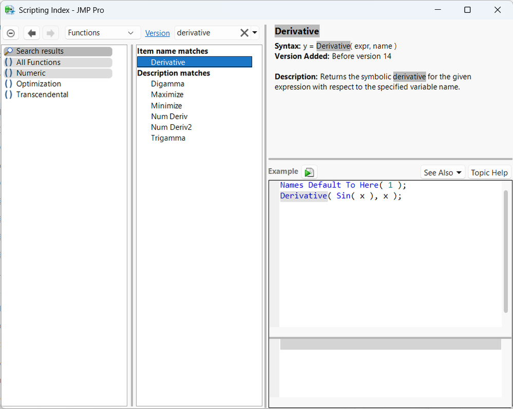

You can call this function from JSL that surfaces the feature from the Formula Editor:

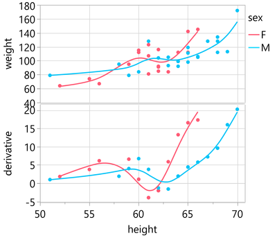

Re: Getting derivatives of a kernel smoother function
wow, really nice, thank!
Names Default to Here(1);
dt = Open( "$SAMPLE_DATA/Big Class Families.jmp" );
gb = dt << Graph Builder(
	Size( 437, 413 ),
	Graph Spacing( 4 ),
	Variables( X( :height ), Y( :weight ), Overlay( :sex ) ),
	Elements( Points( X, Y, Legend( 1 ) ), Smoother( X, Y, Legend( 2 ) ) )
gbb = Report(gb)[GraphBuilderBox(1)];
gbb << updateElement(1, 1, 2, {Save Formula});
nc= n cols(dt);
myFormula = column (dt,nc) << get formula;
Eval (Eval Expr(New Column( "derivative",
	Formula(
		f = As Constant(
			Derivative( Expr(Name Expr(myFormula)),:height	));
		f;
gb << Add Variable( {:derivative, Role( "Y" )} )
