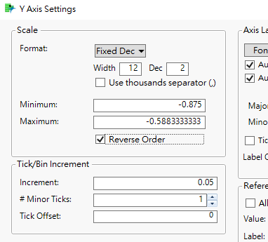

Q: {Reversed Scale} script can't work at control chart builder with mutiple Y Charts
Hi,
I have one question about {Reversed Scale} script can't work at control chart builder with mutiple Y Charts.
It looks no issue on single Y control chart.
I built mutiple Y control charts and modified all charts Y scale to Reverse Order ,then save it to script to table.
But when I run the scrip, the Y Axis looks the same and never reversed.
Attach file is the table with script, could you help?
Is it a bug? How can I solve it? Thank you.

Re: Q: {Reversed Scale} script can't work at control chart builder with mutiple Y Charts
This is a problem with JMP that has been corrected in 17.0.  If you upgrade to 17.0, your JSL will work as expected.
However, there is a workaround that will allow this to work in earlier versions of JMP.  If you send the dispatch commands separately, then this will work as expected in older versions of JMP.
Thank you tonya_mauldin,
It's great to know thank JMP17 had fix this bug
and thank you extra provide workaround solution for me!
Regards,Chily
