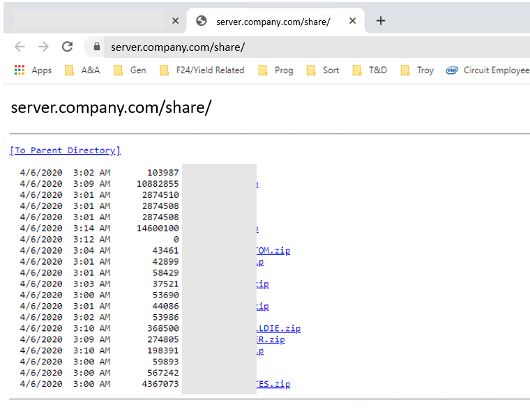

I have published ZIP files and want to programmatically pull them and store to my PC using JSL. I don't know up front how many files will be present.
Is this possible with JSL?
