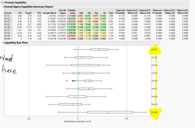

Dear Mark,
Will u pls clarify my doubt? that, in Process capability box plot need the axis in left side of graph. SS attached here, if you have any idea kindly explain me.
Created:
Sep 3, 2021 01:07 AM
| Last Modified: Sep 3, 2021 10:36 AM(2395 views)
| Posted in reply to message from Raj2322 09-02-2021

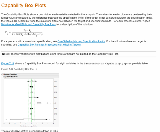

If you go to the Tools pull down menu and select the Help Tool "?" and then click on the Capability Box Plots, you will get the Help pages for them. There is not an axis for the left side of the graph. The axis on the right of the graph label each box plot.
As @txnelson explained, the axis for the variables is on the right side of the plot. There is no option / command at present to change the location. You should see if this change has been added to the JMP Wish List and vote for it (kudo the idea). If there is none at present, then add your own request.
