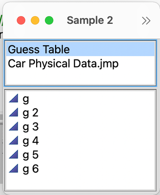

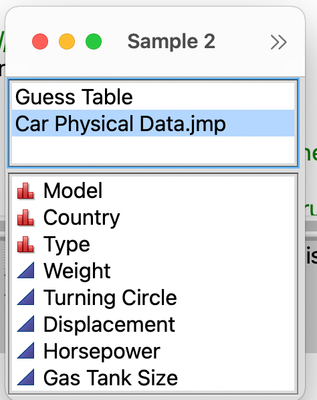

Re: How to Dynamically List Column names of Selected Data Table?
Thank you for your reply. I replace 'col list box' with 'filter col selector', it doesn't work as expected, a red triangle left every time I select a table, the column list doesn't update accordingly.
how does it work through by using 'filter col selector' ?
Names Default To Here( 1 );
//get a list of window names
windows = Get Data Table List();
/*remove ones that are not data tables--need to start at back of list, because its length will change as we delete items
For( i = N Items( windows ), i > 0, i--,
	If( (Window( windows[i] ) << Window Class Name) != "DataTable",
		Remove From( windows, i )
//make a dialog window
nw = New Window( "Sample",
	vlb1 = V List Box(
		lb1 = List Box(
			windows, 	//populate the listbox with data table names
			//here is the script that runs each time someone clicks in the top box
			//delete the current column list box, if it exists
			Try( lb2 << delete );
			//append a new col list box, with all columns of the data table selected in the listbox
			vlb1 << append( lb2 = Filter Col Selector( Data Table( (lb1 << get selected)[1] ), all ) );

jthi
Quickly looking at this there are two things that must be taken care of when using Filter Col Selector:
  1. It seems like Filter Col Selector always uses the Current Data table() and you cannot give it direct reference to the datatable you want to use. Based on the Scripting Index it should accept Datatable(name) as argument so most likely a bug (at least in JMP16.1).
  2. The red triangle of Filter Col Box is a different DisplayBox which has to be deleted.
To work around the reference thing you could try changing the Current Data Table() based on the user selection and to delete also the red triangle, you can wrap Filter Col Box around V List Box and delete that.
