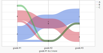

For the parallel Plot in GraphBuilder, is there a setting to use a common Y scale for all parameters? For the plot below, if the grades keep a constant position along the Y axis, it will be much easier ...
