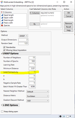

Hi, I've testing both t-SNE and UMAP embedding features in Jmp Pro 17.1 release. t-SNE performs flawlessly, but UMAP just makes the program closes inmediatly as I run the analysis. Jmp closes suddenly without any error prompt or log, no matter the number of samples analyzed (50, 100, 300, etc) or settled parameters. I actually use the MNIST sample data provided in the former UMAP ADD-in dependent on R. Why does it happen? And how can I fix it? Thanks in advance

Hi @Biominer_17 ! Thank you for the question! There is a quick solution for this:
on the Multivariate Embedding platform, click UMAP Options, then you will be able to see a set of UMAP-specific parameters. Please check if the parameter "Local Connectivity" has a missing value . there. You could specify the number 1 for "Local Connectivity". Just like the screenshot below.
Please let me know if you still encounter errors/crashes after trying this.

Re: Problem with the new built-in UMAP feature
Thank you, @Victor_G and @Jeff_Perkinson ! This issue is fixed for JMP PRO 17.2.
Now the issue is gone. For some reason I've omitted that parameter, setting it to 1 has solved the problem. Many thanks to all for your kindness and attention. Thanks for an efficient and quick solution
