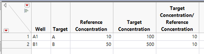

If you're worried about sorting breaking the formula, reformatting your data like the example below would be a different way to do it.

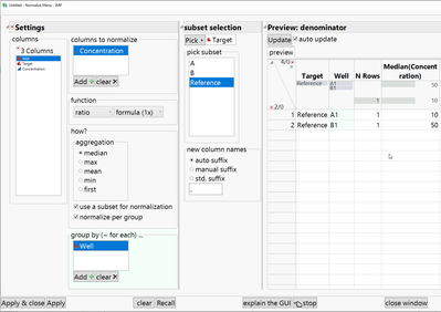

Alternatively, you can try the Normalization GUI:
hogi_2-1680883279580.png from the QuickSelect Toolbar Add-In
For your case, the settings will be:
There are many more options - just click on hogi_3-1680883429528.png and get a guided tour.
