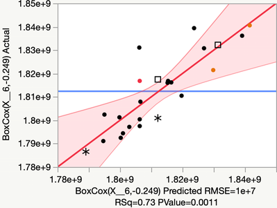

I messed around with modeling your data set a little.
This model for X6 looks pretty good

There is a pretty wild looking transform for x6, but it was easy.
Turn on the Box Cox transformation option, then from the red triangle in the Box-Cox Transformations outline bar, choose Refit with Transform.
The model uses a reduced set of factors
Also, try changing the Y-axis of the profiler to Log from Linear to see the response surface better.
Prediction Profiler
I might have cheated a little on getting the reduced model.  In JMP Pro, I used Generalized Regression, Lasso, Leave One out validation, then relaunched with active effects and added back main effects (didn't enforce effect heredity in the lasso).
Excluding row 4 improves the model statistics. For x6 it looks like a potential outlier.  After reducing the model, loosing this one run has a minimal effect on quality of the design.

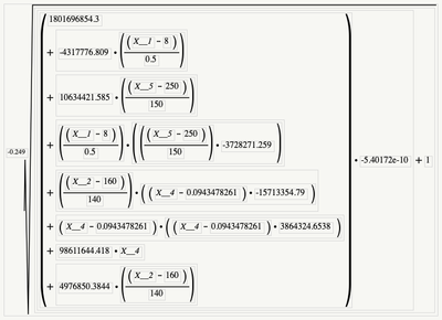

Byron_JMP
Staff
Re: Problem with RSM fit for a factor
1. The transformation tries to find parameters that make the data more normally distributed.
2. The profiler and the saved prediction formula are in the original scale.  Thats why changing the profiler to log scale makes the model more interpretable looking.
3. Well, when the data are super skewed, then the basic assumptions for a linear regression kind of get thrown out.
Also, and maybe more importantly, subject matter expertise informs the transformation. Something like, say, virus or cell counts tend to be log or log10 transformed. But since I don't know what you're measuring (wink/nod, by biologist friend), I just used the Box-Cox transformation JMP suggested, with an aim to get best model possible.
Prediction formula, back transforming the Box Cox transformation.
I'd like to take credit for the math, but JMP does it automatically
