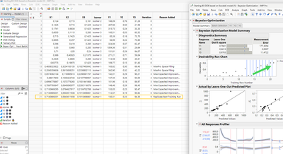

In an earlier R&D study I sucessfully used a 4 factor mixture DOE (3 mixture factors and one 3-level categorical "Isomer" effect) to find optimal settings for a chemical formulation with three quality attributes Y1, Y2 and Y3.
I used the case in a DOE course and used simulation formulas to compute the responses Y123. Good models are obtained and optimization was straightforward and OK, see "ANALYSIS MIXTURE DOE CHEMICAL FORMULATION" in attachment.
Starting from a 12 run mixture Kowalski model DOE I am struggling with  Bayesian optimization (see annex "BAYESIAN OPTIMIZATION") This keeps failing because of a very unreliable Y2 model? Why does Bayesian recommends "Max Desirability" with this very unreliable Y2 model? Starting from other screening & space filling DOE's  I keep getting the same unreliable Y2 model.
What is the problem? How to solve?

Dear Victor and Florian, thanks a lot for you advice, I upgraded to newest JMP version and finally get good results cfr. attachment. Only thing that is not clear is wh after several batches, reason added seems to get stuck on "Maximum Expected Improvement", it does not switch to replication so it seems not to find the optimum, correct? However when I optimize the last batch optimal results are OK, this is not the case after the first Max. improvement. Question is after how many Max. expected improvement to got to optimization, when regression models are OK? What is the most important indicator for Gaussian?

Hi @frankderuyck ,
It's not stuck really...you have an optimization task with 3 responses, where it tries to achieve 3 goals. Since it is still seeing improvement potential, it continues to try to improve. This is indicated in the desirability run chart, as achieved desirability is still improving. When you continue asking for runs, it eventually tries to replicate the current best.
The decision when to stop is tough to generalize - bluntly, you can stop whenever you want, i.e. whenever you feel your goals are met. BayesOpt will try to optimize and verify the results ("Replicate Best Training Run"), depending on the data.
Hope this helps!
