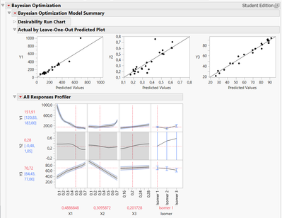

Starting from a 12 run mixture Kowalski model DOE I am struggling with  Bayesian optimization (see annex "BAYESIAN OPTIMIZATION") This keeps failing because of a very unreliable Y2 model? Why does Bayesian recommends "Max Desirability" with this very unreliable Y2 model? Starting from other screening & space filling DOE's  I keep getting the same unreliable Y2 model.
What is the problem? How to solve?

frankderuyck
Level VII
Re: Problem Bayesian Optimisation
Thanks for indepth explanation Victor, however there still are issues:
(1) the Y2 profiler shows that the Y2 model still is very unreliable. (2)  Important(!): the optimal setting here for Isomer = Isomer 2 which does not correspond with the DOE - and correct - solution that must be Isomer 1.
Hard to understand why Bayesion is struggling here..

frankderuyck
Level VII
Profiler Y2 does not look good; DOE model was excellent
frankderuyck
Level VII
After some extra runs, Bayesian consistently yields the optimal Isomer 1 solution, the Y2 profiler remains very grey.
Solution is quite equivalent to what I got, my Y2 R² was lower = 0,52.
frankderuyck
Level VII
The Y2 profiler tells me that one can expect -0,48 < Y2 < 1 correct? Should one  ingnore this result and only look at R²?

frankderuyck
Level VII
Strange, when I click on last BO test I get a different result for the prediction profiler, the plots are the same.
I am using JMP 18 Pro, could it be that version 19 - I suppose that you use the last JMP version - is different?
