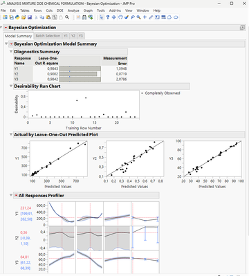

In an earlier R&D study I sucessfully used a 4 factor mixture DOE (3 mixture factors and one 3-level categorical "Isomer" effect) to find optimal settings for a chemical formulation with three quality attributes Y1, Y2 and Y3.
I used the case in a DOE course and used simulation formulas to compute the responses Y123. Good models are obtained and optimization was straightforward and OK, see "ANALYSIS MIXTURE DOE CHEMICAL FORMULATION" in attachment.
Starting from a 12 run mixture Kowalski model DOE I am struggling with  Bayesian optimization (see annex "BAYESIAN OPTIMIZATION") This keeps failing because of a very unreliable Y2 model? Why does Bayesian recommends "Max Desirability" with this very unreliable Y2 model? Starting from other screening & space filling DOE's  I keep getting the same unreliable Y2 model.
What is the problem? How to solve?

Hi Victor, I have tried your proposals with my JMP 18 without succes. Find in attachment a comparison between Scheffé & Gaussian modeling for the full 24 run DOE results: Gaussian modeling is not good showing lack of fit for Y1, very poor results for Y2; Y3 is acceptable; with these gaussian models it is impossible to find optimal mixture settings with profiler, Desirability = 0. Do you get better results with JMP 19? Hopefully a solution can be found, very much I would like to use Bayesian optimisation but my team is getting sceptical..
frankderuyck
Level VII
Re: Problem Bayesian Optimisation
The results from Gaussian prediction formula are very bad and different from Jacknife predictions??
No wonder why my Bayesian optimisation does not work, very inconsistant and unstable results..

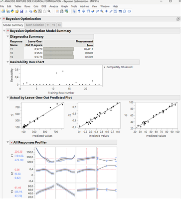

I have used the BO platform in JMP 19 with default settings, and the models for the different responses seem good:
I have saved the prediction formula and script from the Bayesian Optimisation platform (Gaussian Process model) from JMP19 in your table.

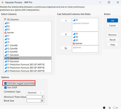

Concerning the "basic" Gaussian Process models, I have similar results for Y1, but you can improve the modeling by checking the option "Estimate nugget parameter" when launching the platform:
As the response Y1 seems to be a bit more noisy than the others, using this option improve the modeling by avoiding the Gaussian Process to perfectly interpolating the data. The model's results are much more interpretable and similar to the regression model, even if the model's predictions can be far from the measurements:
I have also saved the script to re-run the analysis and the prediction formula in your table.
