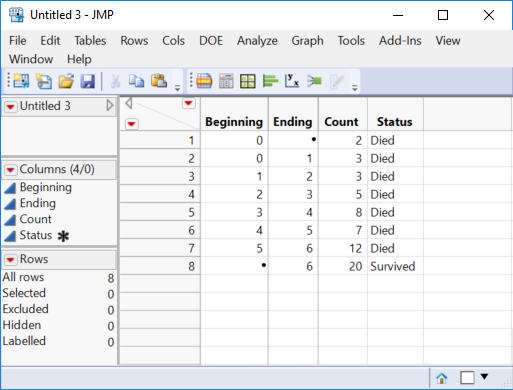

Set up your data to look like this example:
In this example, I have a total of 60 subjects that I monitor from the start of a 6 month program. I need two columns to represent the response (life) because I am not monitoring the subjects continuously but at monthly intervals. This process leads to interval censoring. I don't observe the exact life but instead I observe that it occurs during an interval.
  • The first row represents the start of the test. In this simulation, 2 subjects died at the start.
  • The second row represents the number of subjects who died between the start and the end of the first month (3).
  • The third row represents the number of subjects who died in the second month (3), and so on.
  • The last row represents the number of subjects who did not die by the end of the study (20).
I added another column, Status, to indicate the status of the observations but it is not necessary for the analysis. Perform the analyis by following these steps:

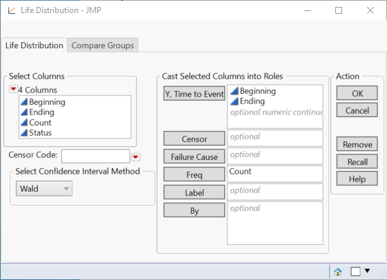

  1. Select Analyze > Reliability and Survival > Life Distribution.
  2. Select Beginning and Ending and click Y, Time to Event.
  3. Select Count and click Freq.
The launch dialog should look like this:
(Note that the Censor analysis role is for right censored data. It is not needed when two response columns are used for interval censoring.)
Click OK.

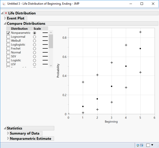

The initial analysis is based on the non-parametric estimates of the failure probability from the Kaplan-Meier product limit. (You can click the red triangle at the top to change it from a Failure plot to a Survival plot.) You use the check boxes and radio buttons on the left side to scale the plot and fit a distribution model, respectively, to the data. Let's fit a normal distribution. Check the Normal check box and click the Normal radio button:
After selecting a model, use the Statistics outline to obtain the desired results. For example, your LD50 is available here as the quantile corresponding to a failure probability = 0.5, so estimate LD50 with the Quantile Profiler:
The LD50 in this example is 3.688803 months (3.22981 months to 4.1478 months with 95% confidence).

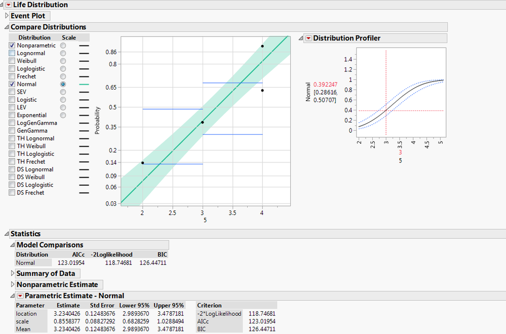

So I used my raw, unadjusted data without my controls and came up with this.
Do I interpret this as:  LD90 for 100% Dose is 4.33 minutes?  How do I determine the fit of this since there is no Chi Square?  (I'm being asked to show a goodness of fit for the model I use.)

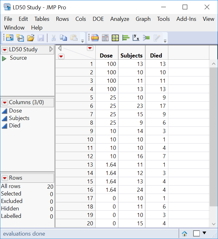

Here's how I set it up and my data:

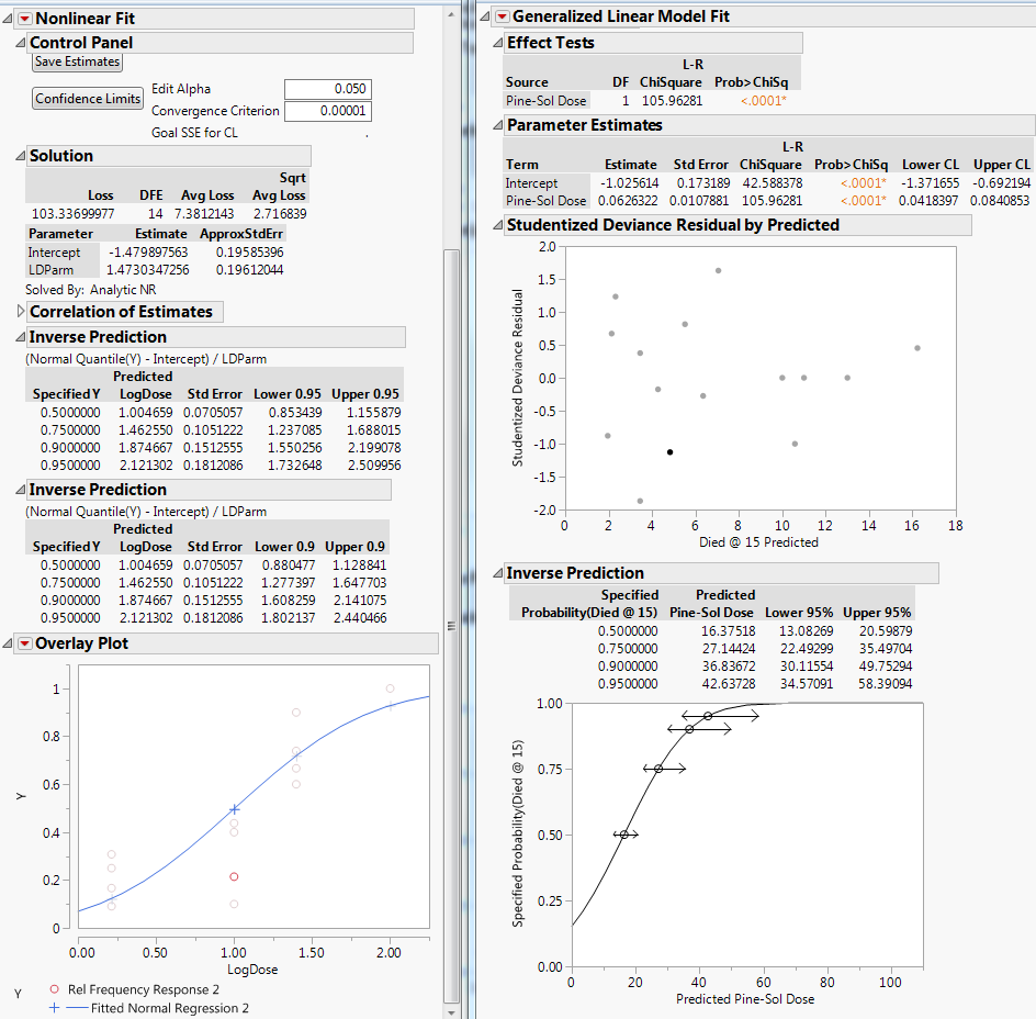

Here is the comparison of the same data in the probit add in vs the gen. linear probit.  If I revert predicted log dose back, it does not match up with the same results in the general linear model.
sassymenace
Level II
Re: Probit Analysis & Fit Testing
I figured it out. Probit Add-In needs live data and it calculates the dead counts itself. Generalize Linear takes the dead counts.

I have one question before I think we can conclude this discussion: why do you have four observations (rows) for each dose? What does each row represent?
Again, forget Life Distribution. Your colleagues are correct, you need a probit analysis. I am working now to make sure that your data table is set up correctly and the analysis is properly defined in Fit Model for a probit analysis. I want to use your previous example of data after you explain why there are four rows for every dose:

I have 4 rows because I performed 4 replicates at each dose. I had 4 doses, 4 reps each. I did monitor each treatment at 1 min, 5 min, 10 min, and 15 min intervals.

Also, do I need to include the Controls/0s? Which would then be 5 doses, 4 reps each.
Yes, you include the control group with dose = 0.
You enter both counts for each dose, so you do not use mortality rate and you do not apply Abbott's correction.
You should perform a separate Probit analysis for each time interval. I performed the correct Probit analysis for the dose-response data collected after 15 minutes already (shown above - the reply with the correct analysis ends with my question for you, "So we agree now, no?"). Let me know if you have any questions.
Perform this analysis for the data collected after the other intervals. Let me know if you have trouble repeating this work.
You should not expect the estimates to be the same for each group (collection time). You should perform the analysis correctly and not compare the results to those from other variations that are not correct.
