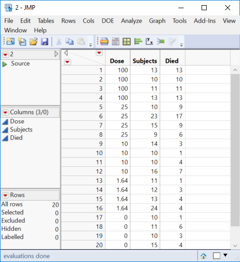

Here is an example of the data:
Dose (% Conc.)Start (#live)Mortality @ 15 min. (#dead)
100.001313
100.001010
100.001111
100.001313
25.00109
25.002317
25.00159
25.0096
10.00143
10.00101
10.00104
10.00167
1.64111
1.64123
1.64134
1.64244

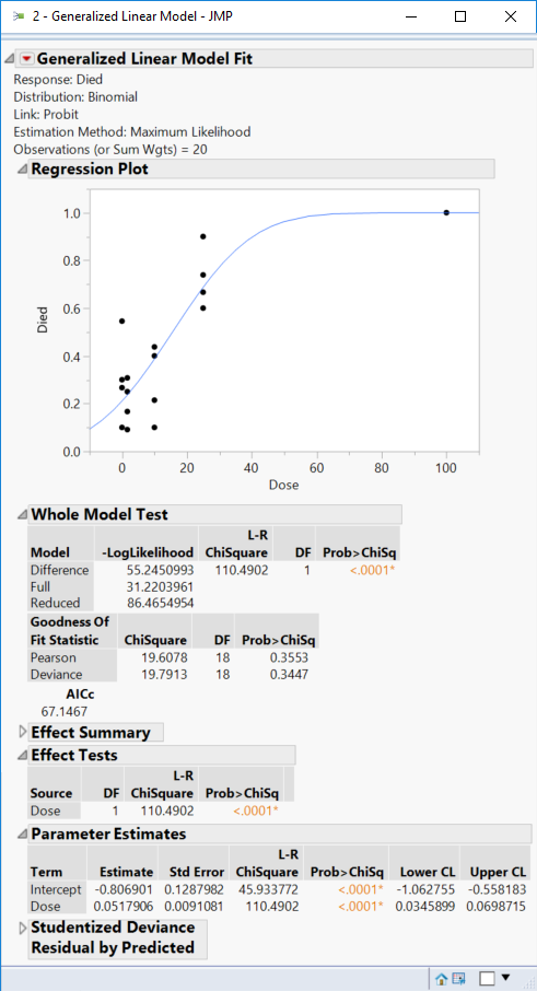

OK, I think I understand now. I was correct to begin with and it is not a survival analysis (life time). We are back to my GLM example but now I will use your data. Here is your data in a JMP data table:

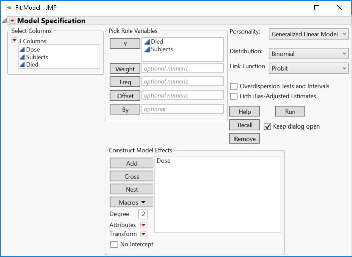

Set up the Fit Model launch dialog as before:
Click Run and then you get these results:
Click the red triangle next to Generalized Linear Model Fit and select Inverse Prediction. Type 0.5 (and any others that you want) for Probability (Died) and click OK.
So now we agree, no?

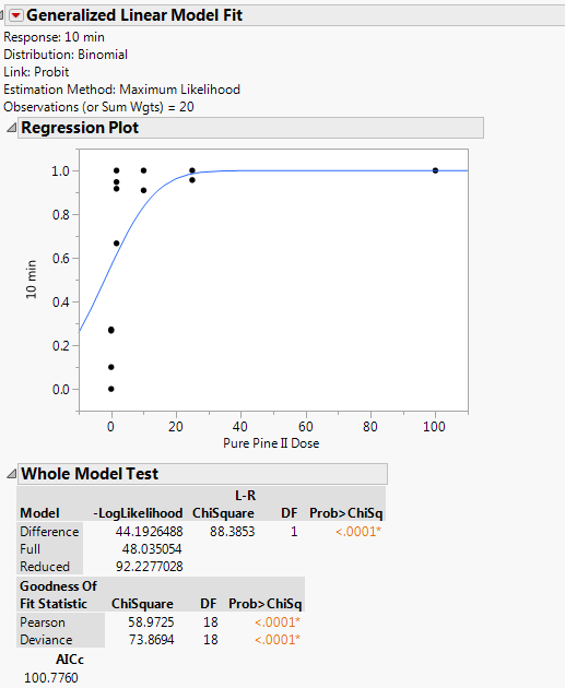

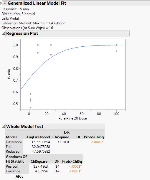

Re: Probit Analysis & Fit Testing
  • Is it a data problem?
    • Do you have outliers or data errors?
    • Did you accidentally exclude rows that should be included?
  • Is it a model problem?
    • Are you using the correct response columns?
    • Are you using the correct predictor column?
    • Is it lack of fit?
  • Is it a model assumption problem?
    • Are the errors distributed as expected?
    • Are the errors constant over the entire range of the predictor?

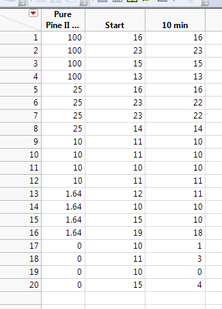

Here is one of the data sets in particular I'm having issues with. If I Hide/Exclude the 0s, the model will fit.
You didn't answer any of my questions.
This example must be a different agent than the example that you tested at 15 minutes. It doesn't make sense that the same agent would be that much more lethal with just five more minutes of exposure.
You must use a different dilution/dose range (higher dilution, lower dose) to observe the transition. The highest dose should be 1.64. You should include the zero in the test and in the data analysis. This new data is the only way to fit the probit model for this agent at this time point.

It is a different agent. I tested a total of 6 different agents. I'm being asked to give recommendations at 10 minutes if possible, and 15 minutes as a max. I have a couple of data sets similar to this, where there is very high mortality at doses above 1.64 or 10%.
Why does the model not work in these situations with high mortality at the higher doses?
I think most of it has to do with the data, as I had some strange effects on a couple of the agents. I've had the situation where a lower dose worked more effectively than a higher dose. The model doesn't work in that situation either. A couple at 100 were less effective than lower doses due to evaporation, but the models work fine if I exclude those doses.
In another set, my controls all experience 0 moralities (different species than previous control). Those seem to be causing discrepancies as well.
I cannot speak to the discrepancies that you cite, but they call the data into question.
The problem with fitting is that the data exhibits the 'separation' problem. At one level (dose = 0), you have the low response and at all of the other levels (dose > 0), you have the high response. The transition from low to high response is impossible to determine. Try to find LD50 on your own with this data and you will understand the issue. (Does it occur at 0.1? At 0.5? At 1.5?)
You must perform another dose-response test where the dose ranges from 0 to 1.64 in order to fit the probit model and estimate LD50.
