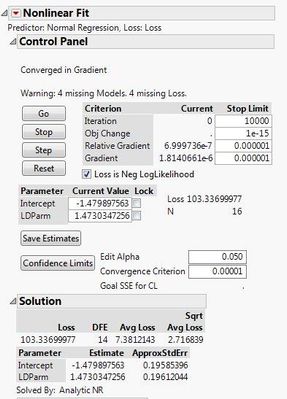

I am using the Simple Probit Analysis script add-in to determine LD50, LD90, and LD95.
Is this script capable of correcting with Abbott's, or how do you set this up?  Currently, I corrected the data myself by applying the Abbott's correction to the raw data to adjust for mortalities.
After running the Probit Add-In, how do I determine goodness of fit?  There are no Chi Squared results.  Is there another way I can run this analysis to get my LD values, as well as getting the Chi Square?

I have been attempting to run the model in the Generalized Linear with Probit, however, my LD values do not match up with what the Probit Add-In is giving me, so I'm not sure what is going on.  I've read through the Fitting Linear models, but what I am trying to run analysis on is nonlinear, which I honestly don't have any experience with in JMP.

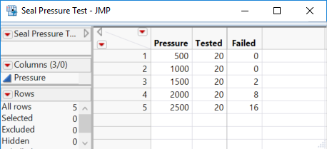

We are testing seals for failures at increasing pressure levels. Here is the data table with the preferred layout:
Note that we do not enter the failure rate (Failed / Tested) for the response.

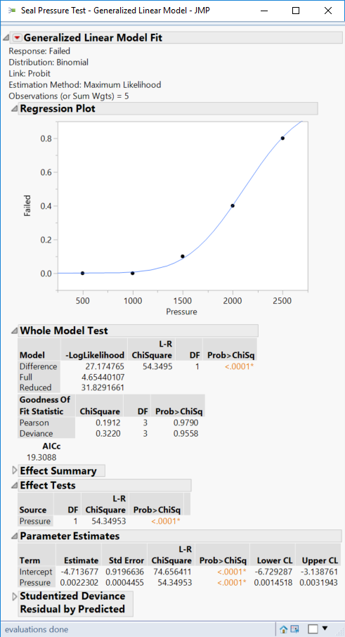

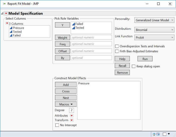

Select Analyze > Fit Model. Select Pressure and click Add. Select Failed and click Y. Select Total and click Y. (Note that (1) you must enter a column with the count of targets and another column with the count of opportunities and (2) the must be entered exactly in that order.) Click Standard Least Squares and select Generalized Linear Model. Select Binomial for the Distribution model. Select Probit for the Link function. Your launch dialog should look like:
Click Run.

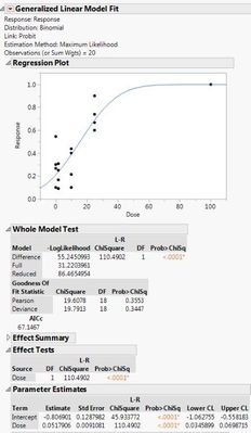

You can see the non-linear response and the regression diagnostics below:

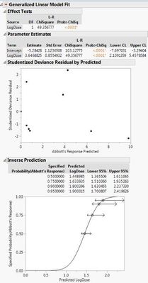

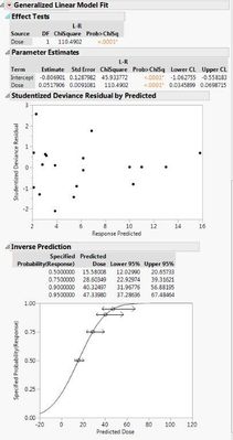

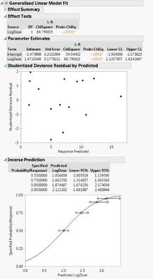

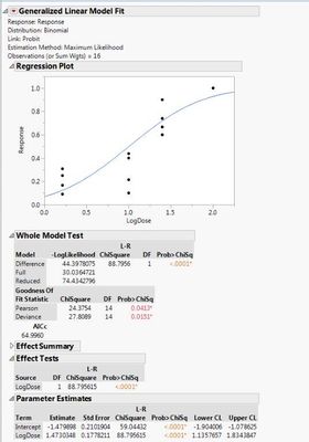

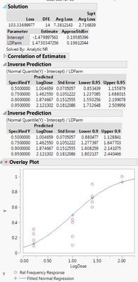

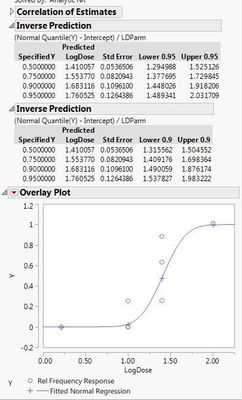

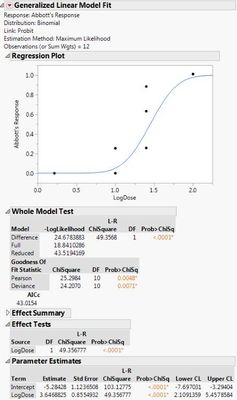

Abbott's Gen. Lin.pg 2Abbott's Gen. Lin.pg 2Abbott's Gen. Lin. pg 1Abbott's Gen. Lin. pg 1Abbott's ProbitAbbott's ProbitRaw Data with 0s Gen. Lin. 1Raw Data with 0s Gen. Lin. 1Raw Data with 0s Gen. Lin.2Raw Data with 0s Gen. Lin.2Probit Raw Data with 0s 1Probit Raw Data with 0s 1Probit Raw Data with 0s 2Probit Raw Data with 0s 2
Here are the two different results I'm getting with the different data sets.  If I use the 0s and my raw data, both the probit model and the general linear probit model seem to match up.  However, if I correct my data with Abbott's correction and leave out the 0s, then the two models don't match up.

I attached the wrong Linear models with raw data. Here are the correct:  Gen. Lin. Raw Data 1Gen. Lin. Raw Data 1Gen. Lin. Raw Data 2Gen. Lin. Raw Data 2

Abbott's correction is applied to mortality rates (i.e., proportions) to account for the natural mortality in the absence of the agent be tested. GLM is modeling a binomial distribution with a linear predictor. The GLM model has an intercept for that purpose (baseline mortality). So it is not necessary to apply this correction and doing so will, in fact, change the output. So don't do it if you are using GLM for your analysis.
