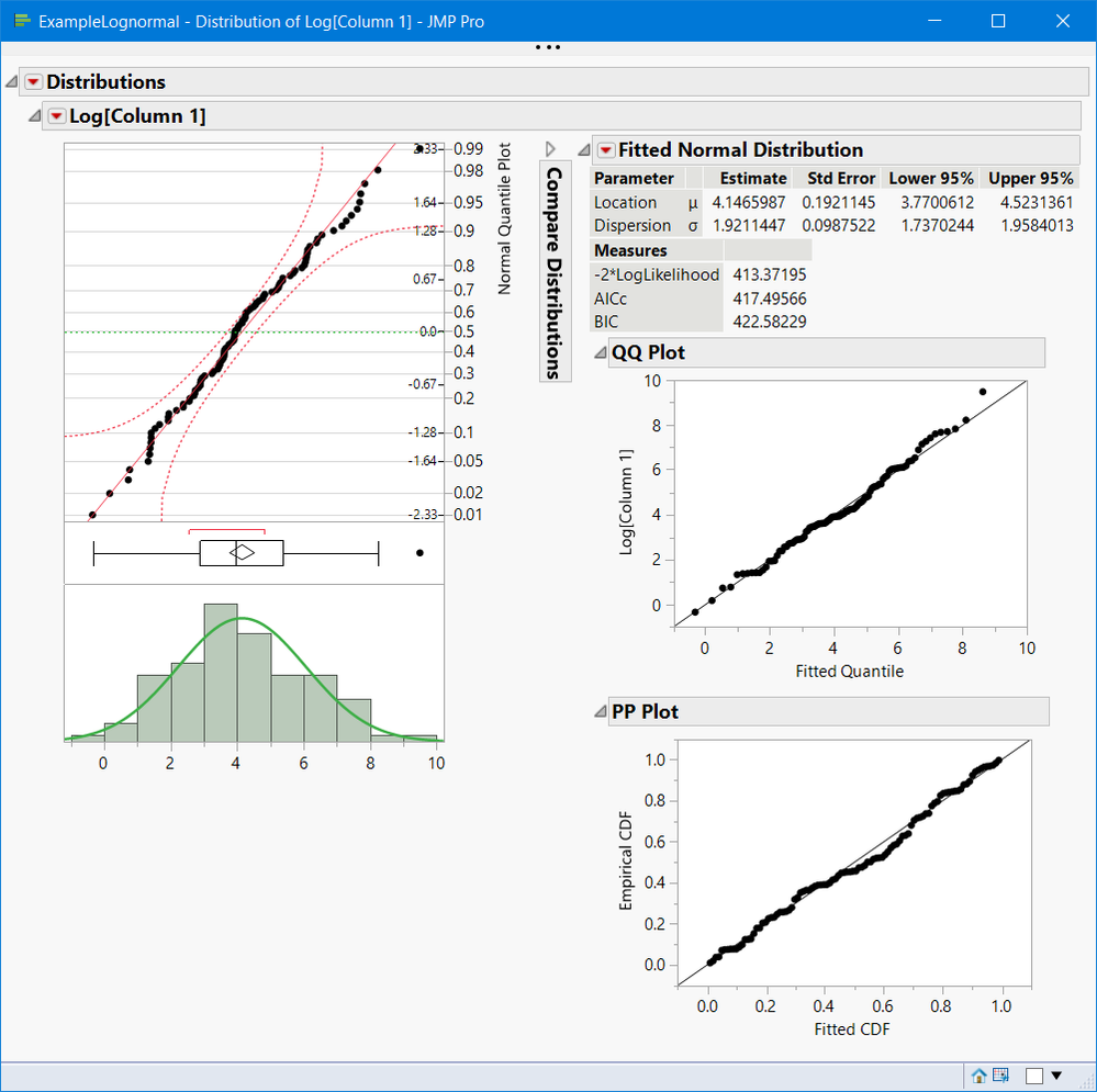

Below is a screenshot of  Analyze > Distribution > Continuous Fit > Fit Normal of 100 random lognormal(4,2) values transformed with Log. The table with script is attached.
Another suggestsion is to use the QQ plot that Hadley suggested and click on the Y axis of he QQ plot and change Linear to Log.

Re: Probability plot for log-normal distribution fitting
@mtrain,
@HadleyMyers provided you with a solution. However, if your lognormal distribution has a large mean and/or variance, the scaling on the QQ plot usually does not have the familiar custom probability plot that scales the Y axes like custom probability paper (yes I am showing my age, things we used pre graphical calculator/computer days).
I suggest you right click on the column of data you're fitting, select Transform and use Log, then Continuous Fit >  Fit Normal.
Hi gzmorgan0,
I agree, making the log transformation is a great way to get the intervals on the plot too. I did this before but was also wondering about getting a plot for the log fit. The PP/QQ do a good job.
Thanks for the help.
