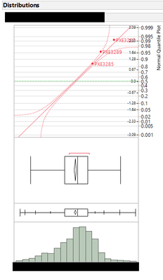

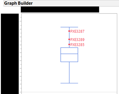

So a colleague of mine made some test samples and wants to compare them to commercial production results. See attached output.
  1. He labeled the test sample rows. He wanted to compare where they are relative the box plot of the commercial results. The only way he could see on the labeled rows and not the other rows was to hide the other rows in Graph Builder.
  2. Better would be to compare the test samples in the Distribution platform. Other than the Normal Quantile plot, how can just the test sample points shown on the box plots or the histogram?
Is there a better way than the 'hide-the-rows' trick?
Thanks!

Hi,
I'm not sure that this simple approach will work for you but have you tried the command Rows > Row Selection > Select Labeled then assign a color and/or specific marker to the select rows?
