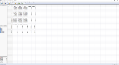

One more question. If I am doing this with two sets of covariates (one PC set for elements, and another for solvents), how would I do this? I tried to put another set in the table that has data occupying different rows than the first PC's just as a trial (as seen below), and the design failed
Thanks.

You cannot combine two sets of PCAs as covariates. Custom Desing considers the table of covariate values as the runs in your design to be completed with the levels of the other factors. JMP finds the optimal factor levels in combination with the covariate combinations. Operationally and philosophically, you would need a covariate data table with the metals and the solvents. Still, there is no meaningful way to match the metals and the solvents row-by-row. They are truly independent.
