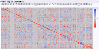

Have you tried the color map in the multivariate analysis when you have more than 15 parameters?
Thanks, I didn't know that was available! It definitely condenses the results.

Yes ever since we added that feature it is my "go-to" visual. My brain seems to assimilate the data more readily.
